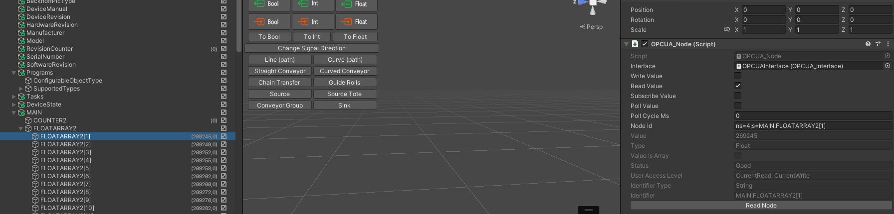

Unfortunatly i cant get values for arrays though.
Example for the absolutePosition node:
The OPCUA_Node is recognizing that the node is an Array, but still wont fill in any actual values.
Image 1179
I doublechecked the values of the node using the OPCWatch tool:
Image 1180
I cant find anything related in the forums or the documentation.
How to handle arrays?
Kind regard
Mike
Don't know why the array is not imported on your side. Can you try manually setting the array Nodes like this:
Image 1183
