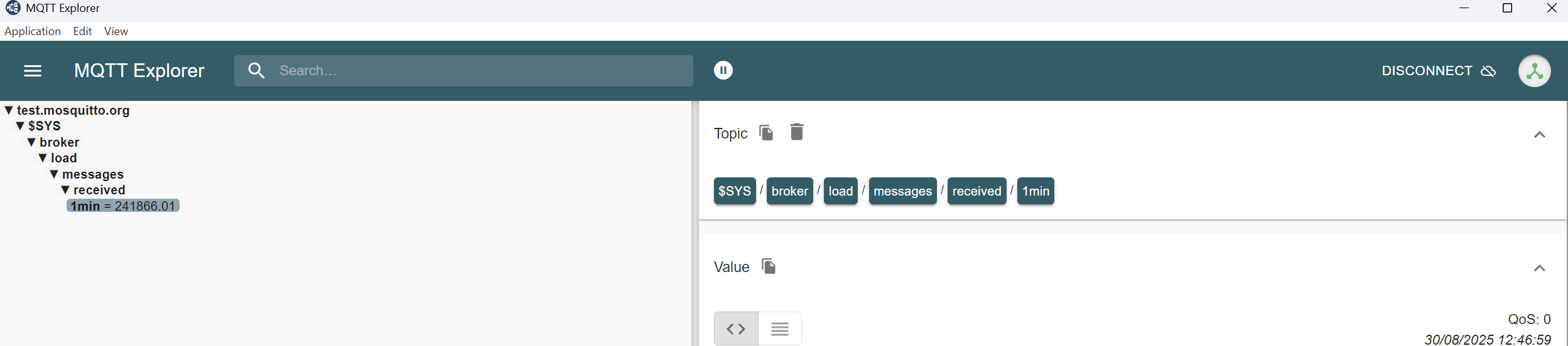

The real problem occurs when it needs to import topics.
mosquitto broker hierarchy

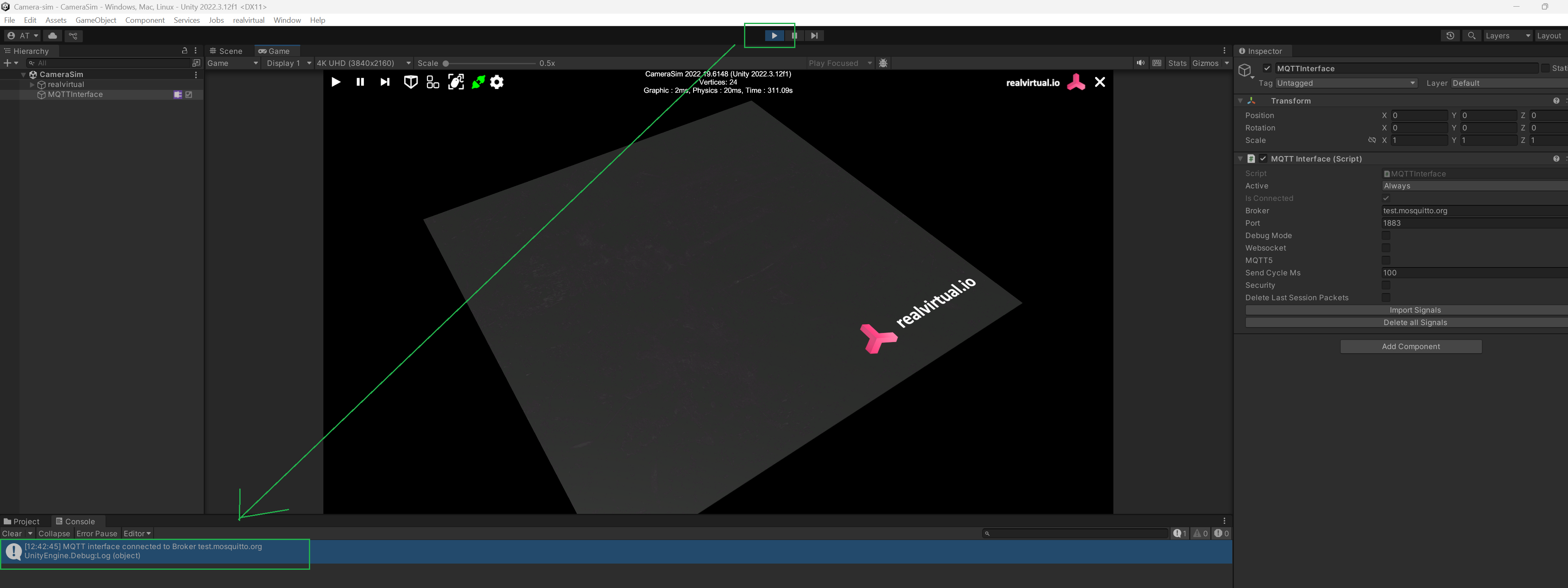

Image 1372
It can connect
Image 1371
But it cannot import
