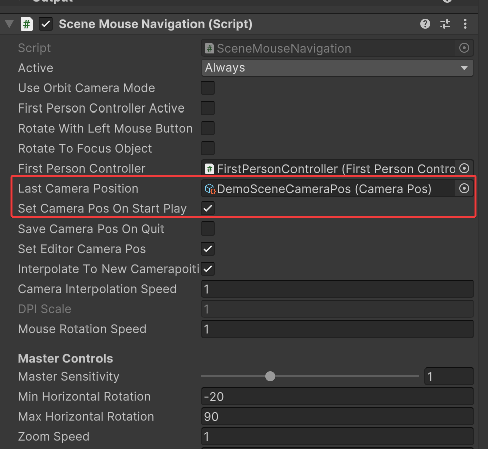

you can set this like this:
Image 1396

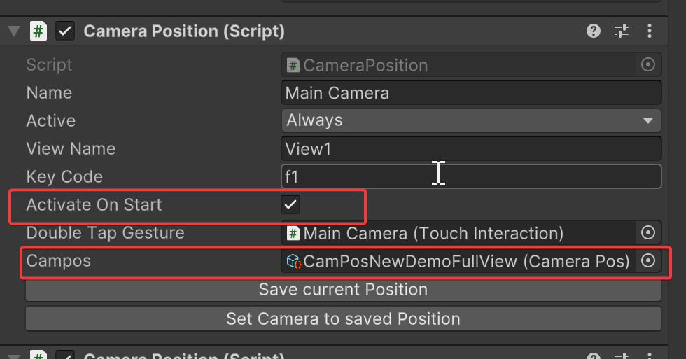

or you use camera position script - attached to main camera. Make sure that both settings dont interfere (just use one):
Image 1397
I tried it but when changing to game mode the camera swings to another position.
Image 1402
I deactivated he camera positions scripts completely.
Why is the camera still moving?
