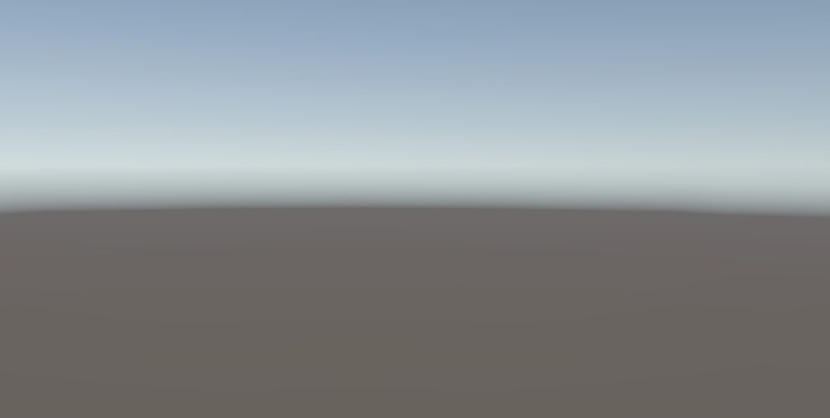

For this I just imported the RV6 package and created a build but the game looks like this.
My Unity version is 6000.0.58f2.
Image 1400
Did the build succeeded - any error messages in the console log? This looks lika build of an empty scene. Are you sure that you have selected a realvirtual.io based scene in your build settings?
Hi Thomas,
yes you're right. I wasn't clear that I had to select a scene in the build settings. This seems to be different in Unity 2022.

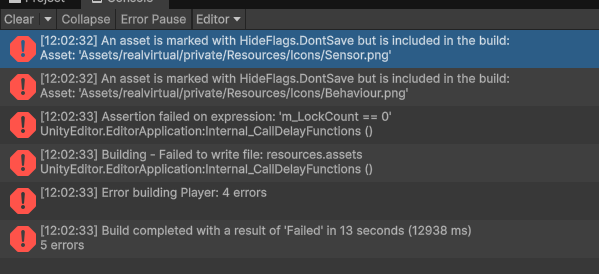

Also I had errors in the console:
Image 1401
I remember those similar errors when doing a build in Unity 2022.
What I had to do is to change the texture type of both 'png' to something else and then back to default. Is this a known problem?
After fixing that and selecting the demo scene the build is working properly.
