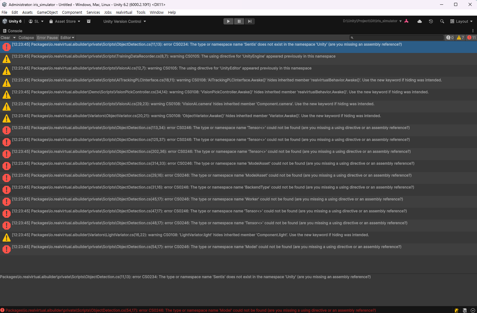

I'm having trouble with a compile error after installing RealVirtual AI Builder.

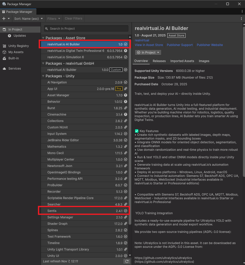

1) Install Sentis (InferenceEngine) 2.4.1
2) Install RealVirtual AI Builder 1.0
→ Compile error occurs (see image below)
To resolve this issue, I tried changing Unity.Sentis to Unity.InferenceEngine in the ObjectDetection.cs script where the error occurs, but this did not resolve the issue.
I would like to request guidance on how to resolve this issue so I can use RealVirtual AI Builder.
※ Package Installation Status: RealVirtual AI Builder & Sentis
Image 1413
※ Compile Error Status
Image 1414
Hello,
thank you for sharing your issue.
We only support Unity 6 LTS versions. You need to open your project with a Unity 6000.0.x version. The Sentis package should default to version 2.1.3 and resolve the issue

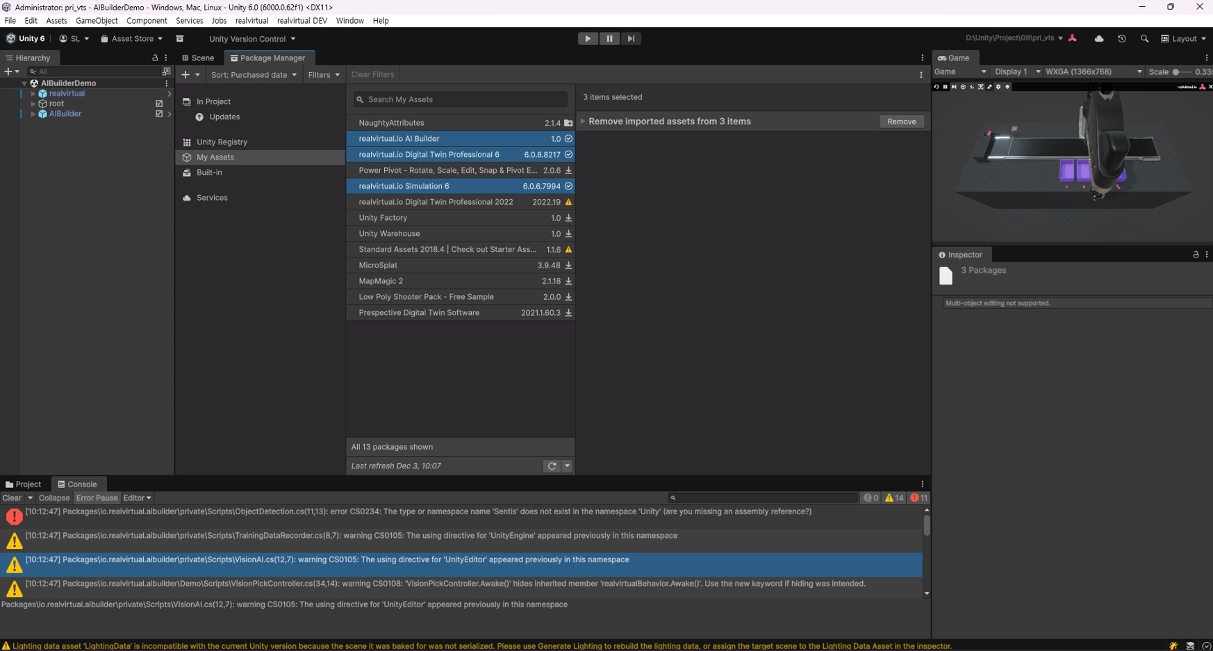

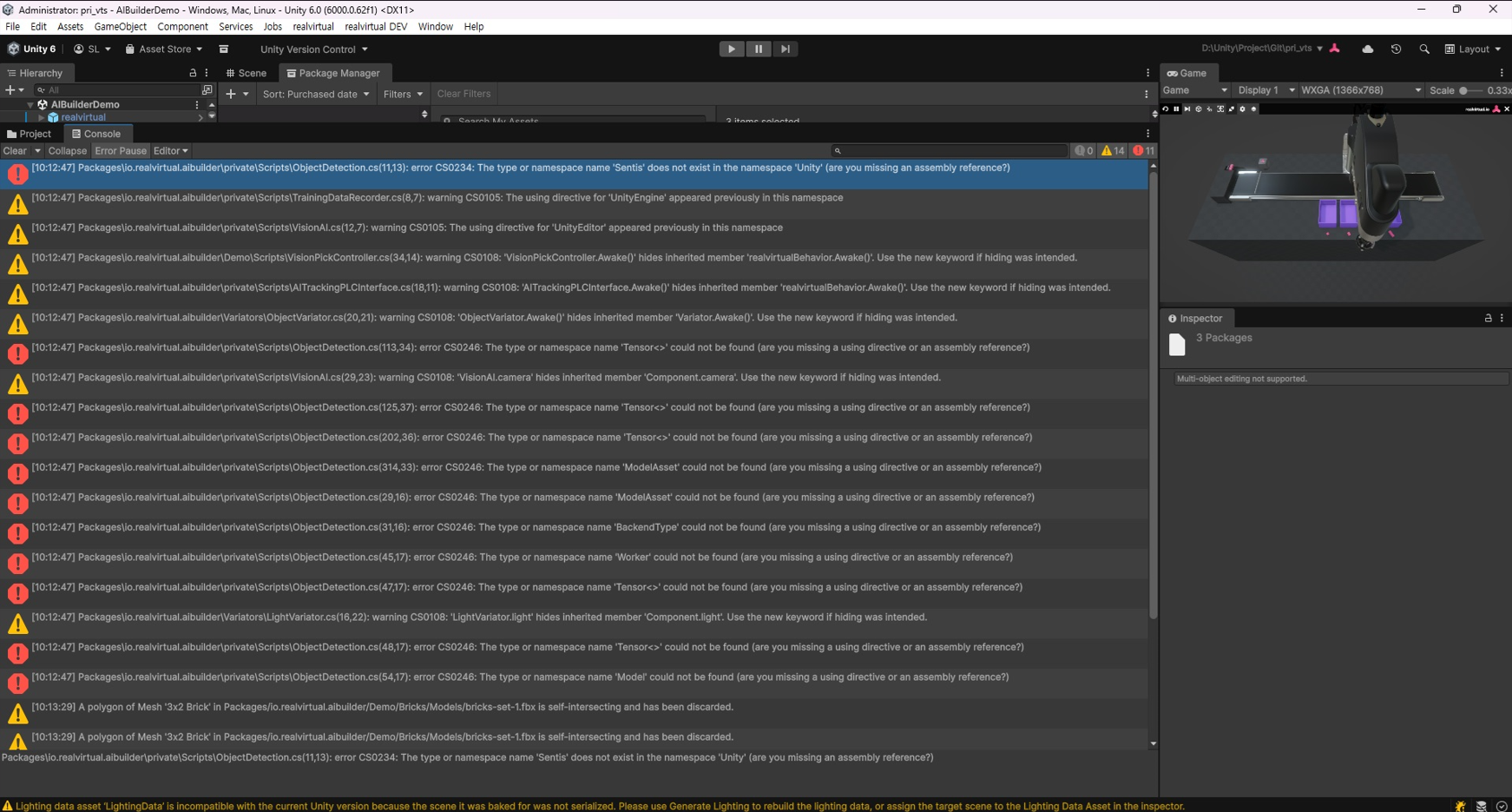

I'm having trouble again with a compile error after installing RealVirtual AI Builder with Unity 6 LTS version.
1) Unity 6 LTS Version (6000.0.62f1)
2) Install RealVirtual IO Digital Twin Professional (6.0.8) & Simulation 6 (6.0.6) → OK
3) Install RealVirtual IO AI Builder 1.0
Image 1434
Image 1435
