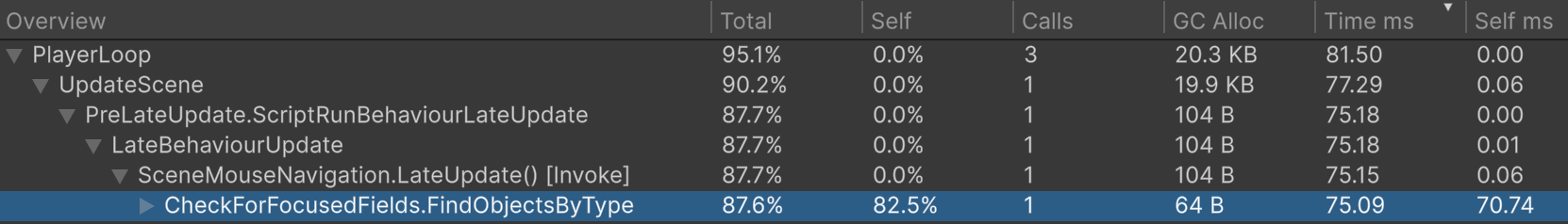

LateUpdate in SceneMouseNavigation calls CheckForFocusedFields which uses FindObjectsByType.
On large scenes, this per-frame global lookup produces unacceptable frame times.
FindObjectsByType should not be called every frame.
This is the profiler result with 4000 active and 400.000 inactive objects in the scene:
Image 1416

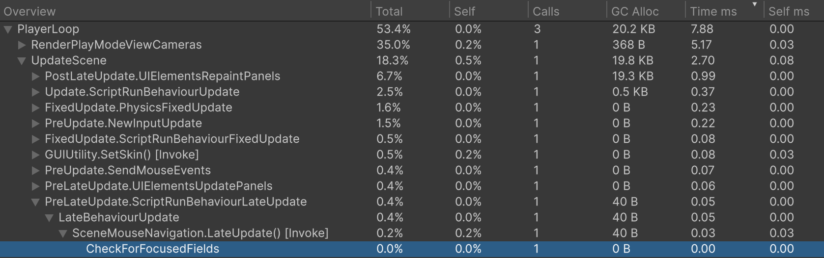

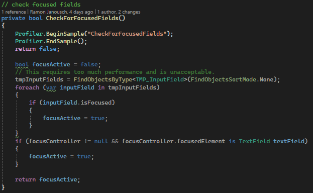

Same scene with an early return in CheckForFocusedFields.
Image 1417

Thanks for reporting - we are checking for a solution - maybe caching it and will let you know.
Hi, thanks for reporting and finding the issue.
Please relace the method by this:
//! Check if any UI input field has focus - uses EventSystem for O(1) performance
private bool CheckForFocusedFields()
// Check if currently selected GameObject is a TMP_InputField (O(1) performance)
var selectedObject = EventSystem.current?.currentSelectedGameObject;
if (selectedObject != null)
var inputField = selectedObject.GetComponent();
if (inputField != null && inputField.isFocused)
return true;
// Check UI Toolkit focus controller
if (focusController != null && focusController.focusedElement is TextField)
return true;
return false;
We will inlclude this in the next update.
