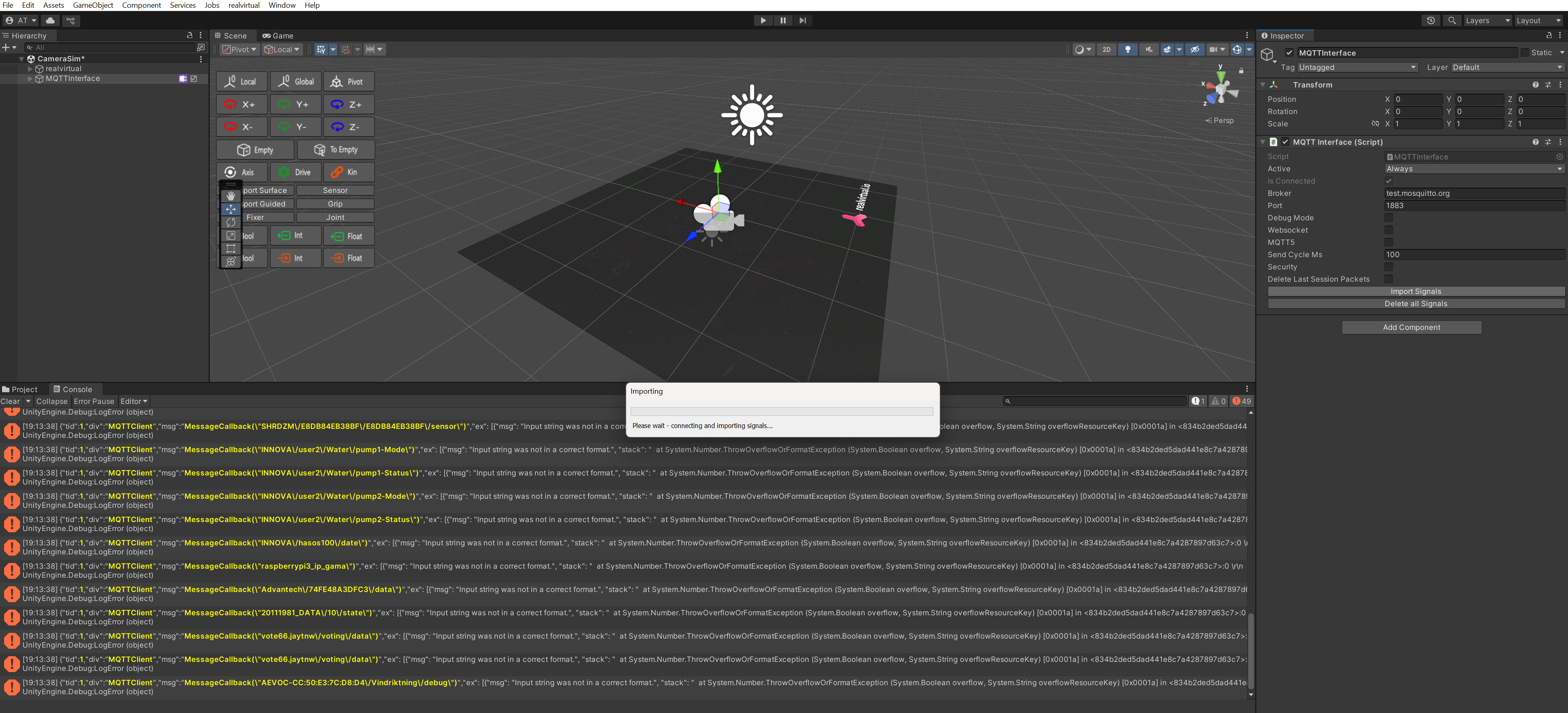

Full error after pressing the Import Signals button
Did you use my BEST.HTTP package or yours?
Is it possible that for some reason it cannot store data on my Host PC?
Or am I doing something wrong?

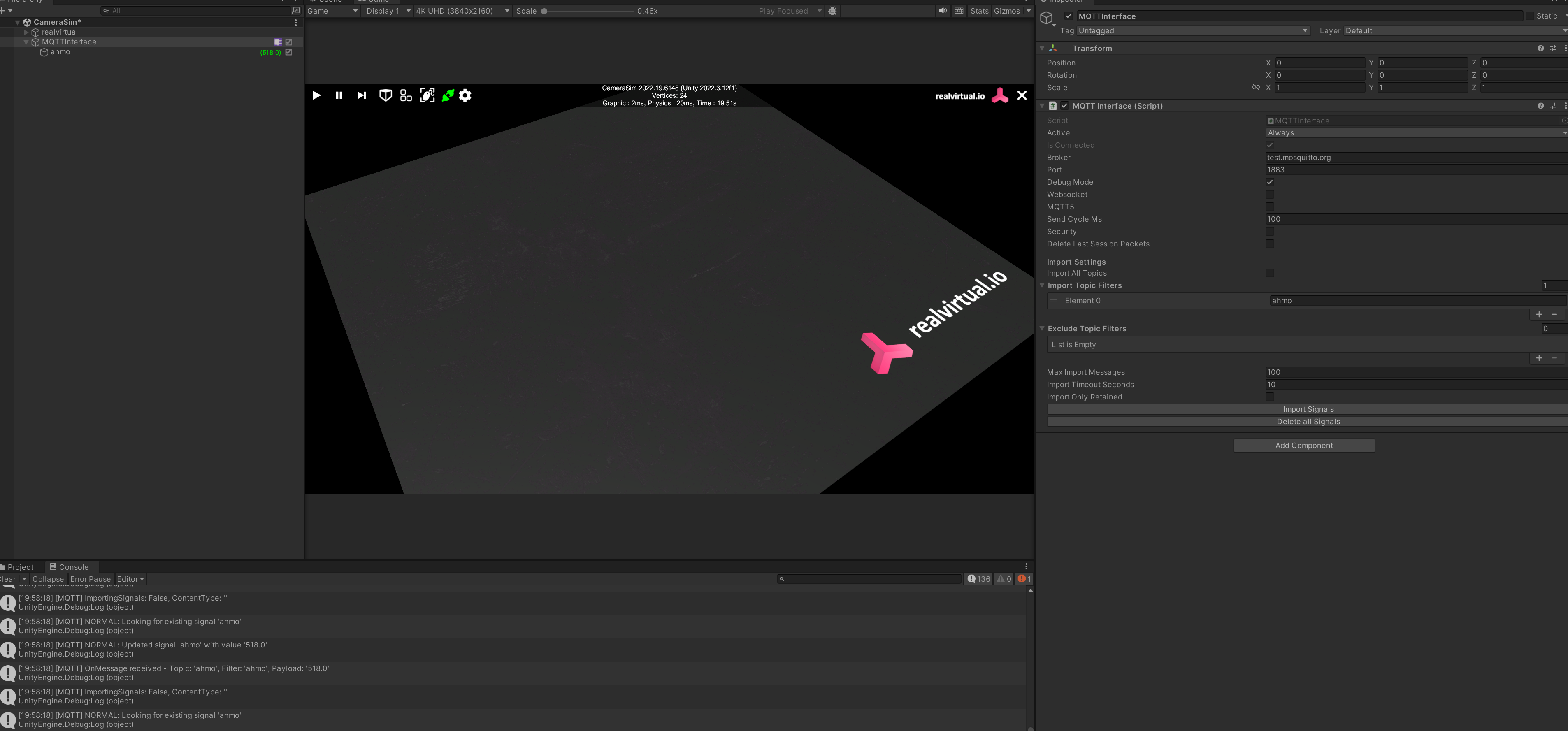

Tested with the Mosquitto test broker "test.mosquitto.org" and port 1883, but the same error occurs.
I deleted everything in the Session folder, but nothing helps.
I do not have this problem when communicating with Python code — only with the Unity realvirtual MQTT interface.

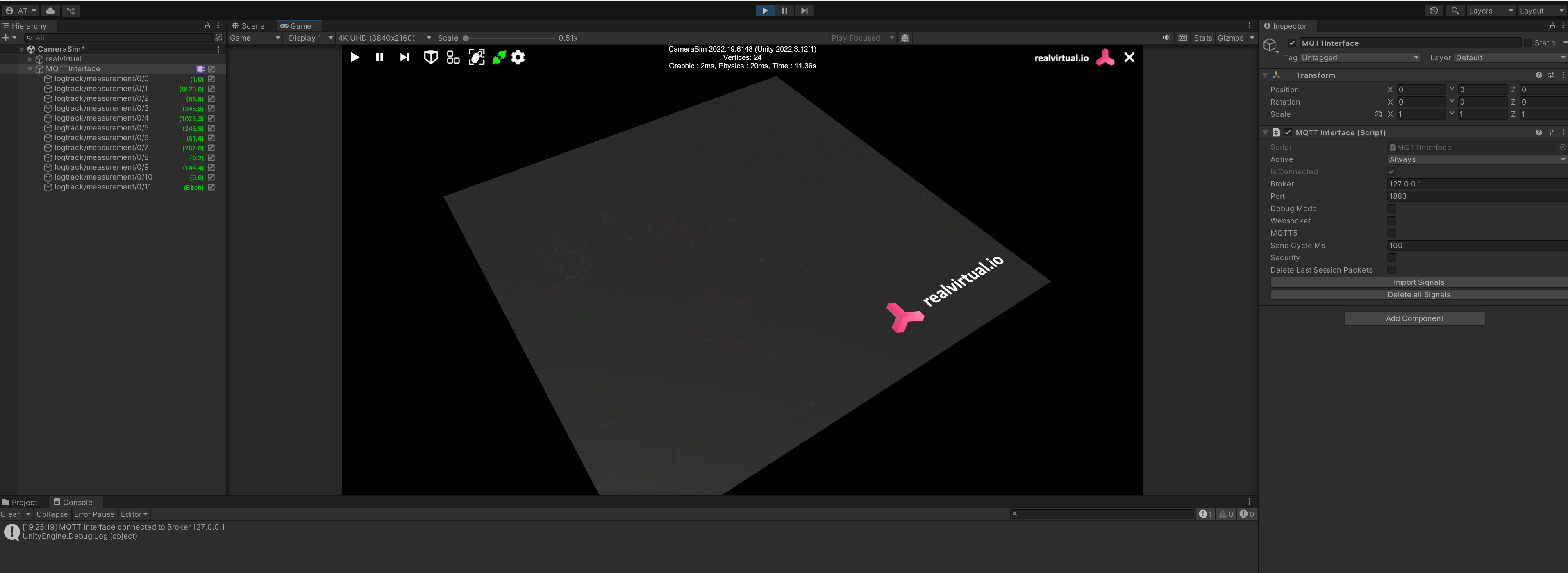

Also, I do not have problem when using the realvirtual MQTT connection with a local broker for example 127.0.0.1 and port 1883
test.mosquitto.org
Error
