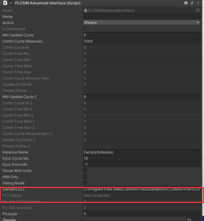

Hello Sir,
  Currently I have added the PLC Advance interface to my project. Also successfully to run the PLCSim advancedCoupler.exe. But after that, it shows that PLCSIMAdvance runtime not available. Can you please help on this
Image 1149

Yes sir, We have followed the procedure step by step as per your shared link. Also the dll file is automatically came in the path. And after trying to import data/run the simulation, Same dll is coming in the streaming asset folder. but still the problem remains same. i.e-> PLC advanced runtime Not running.  Please find the attachment
Image 1150

There is no error in the console log. Also the siemens DLL path is also looks fine. Pleas look into my attachment
Image 1154
Please turn the DebugMode on on the PLCSimAdvancedInterface and check the log (both console and unity).
Please also replace your PLCSimAdvancedCoupter against this one and send us what you see in the Console log: PLCSimAdvancedCoupler.zip
