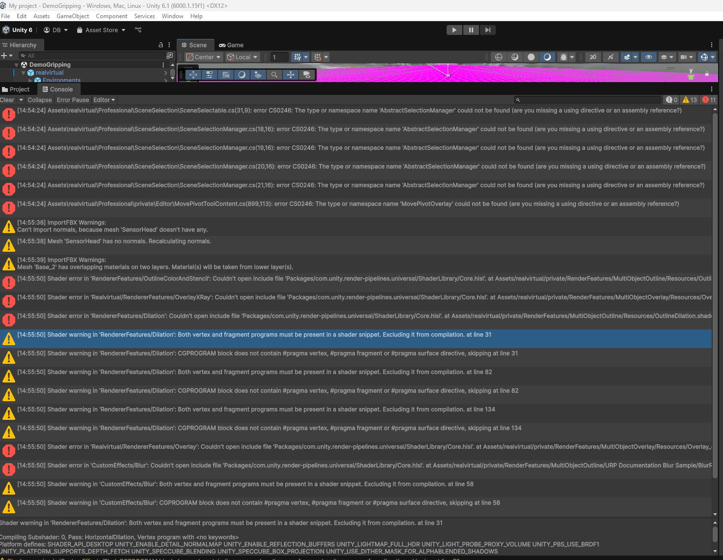

Hello. I run unity 6000.1.15 and just downloaded and imported realvirtual professional from MyAssets.
I can see no realvirtual menu bar, no demo scene was opened and i receive these errors:
Image 1341
Am i doing it wrong?

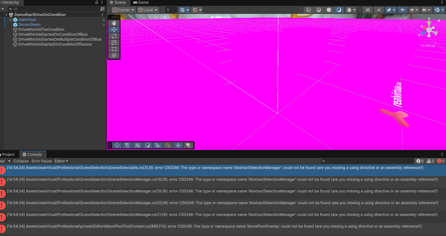

Tried importing again and now have these errors. Cant press play due to compiler errors.
Image 1342
Hi, i think it is because you are not using 6.0 LTS (you are using Unity 6.1)

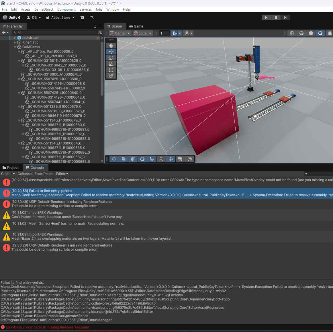

Thanks for input. I replaced the installed version with Unity 6 LTS. Now these alarms are shown when i want to press play.
I have not gotten the "realvirtual" menu choice either.

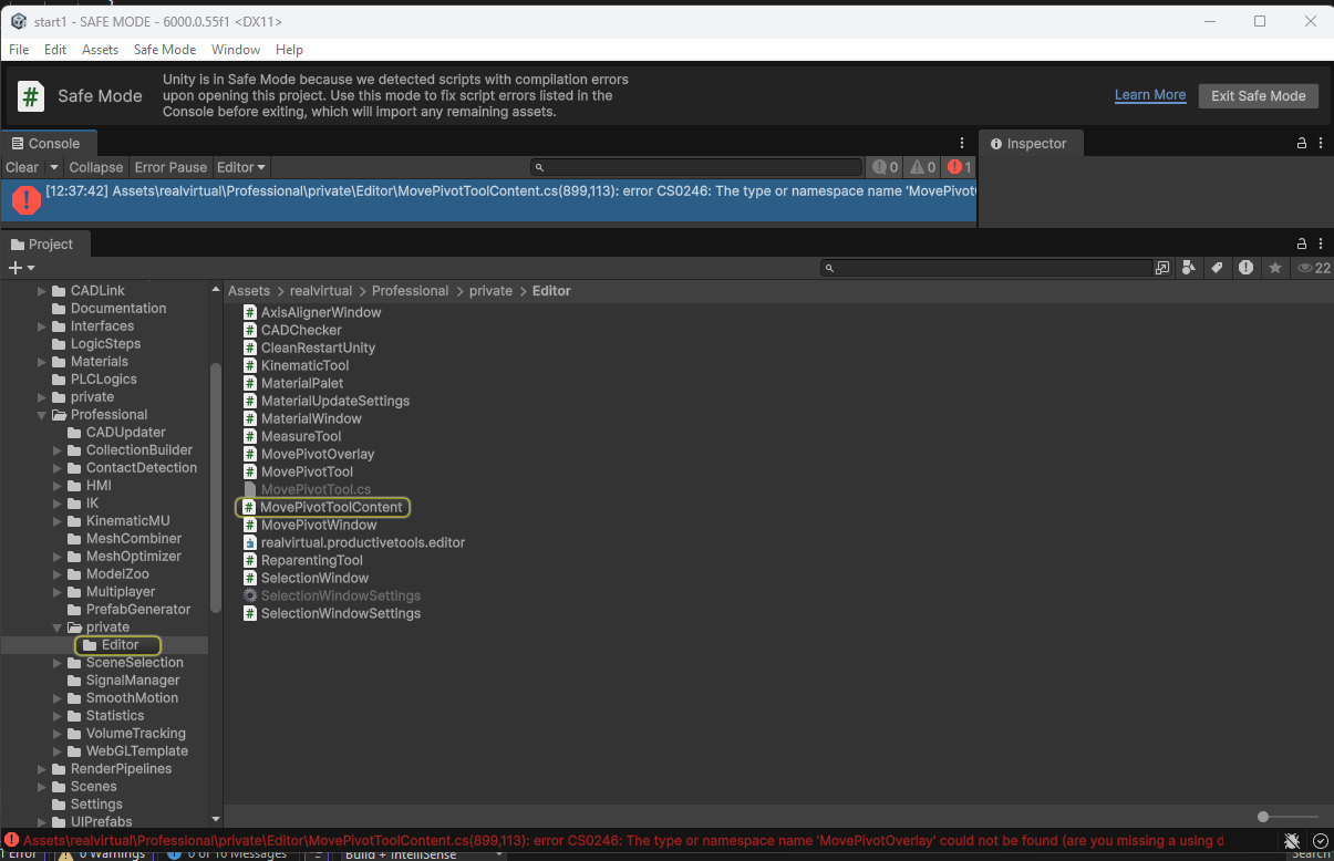

I tried importing again and this turned up:
Image 1349
Image 1350
Hi, this is very strange. Did you started with a clean project. Also something to try - maybe there is old stuff in your Library Folder - close Unty, delete the Library Folder within your Unity Project and restart the Project again.
If this not helps please send us the project to:
https://realvirtual.io/send
Created a new project and the same thing happened. Have uploaded the projekt to the link you supplied.

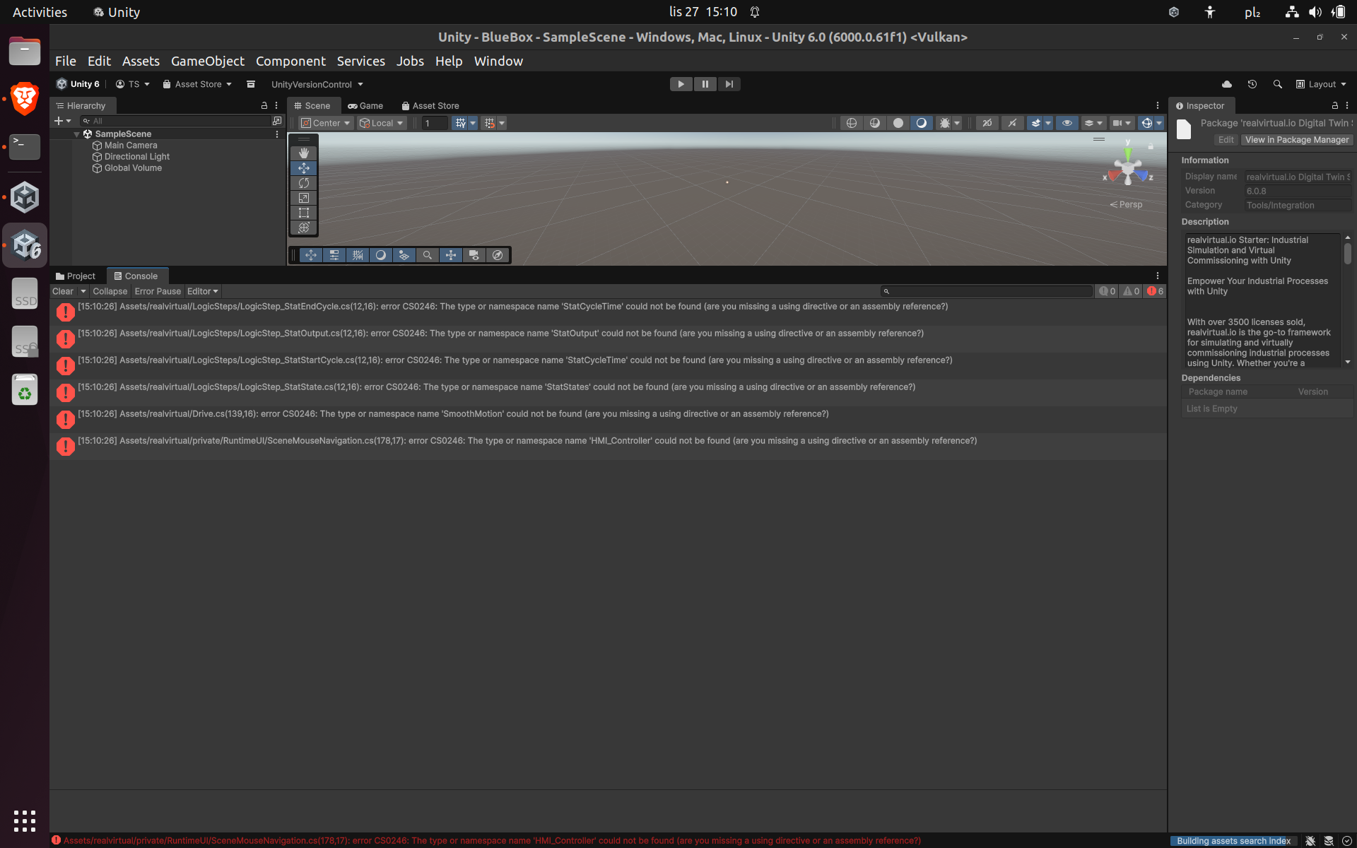

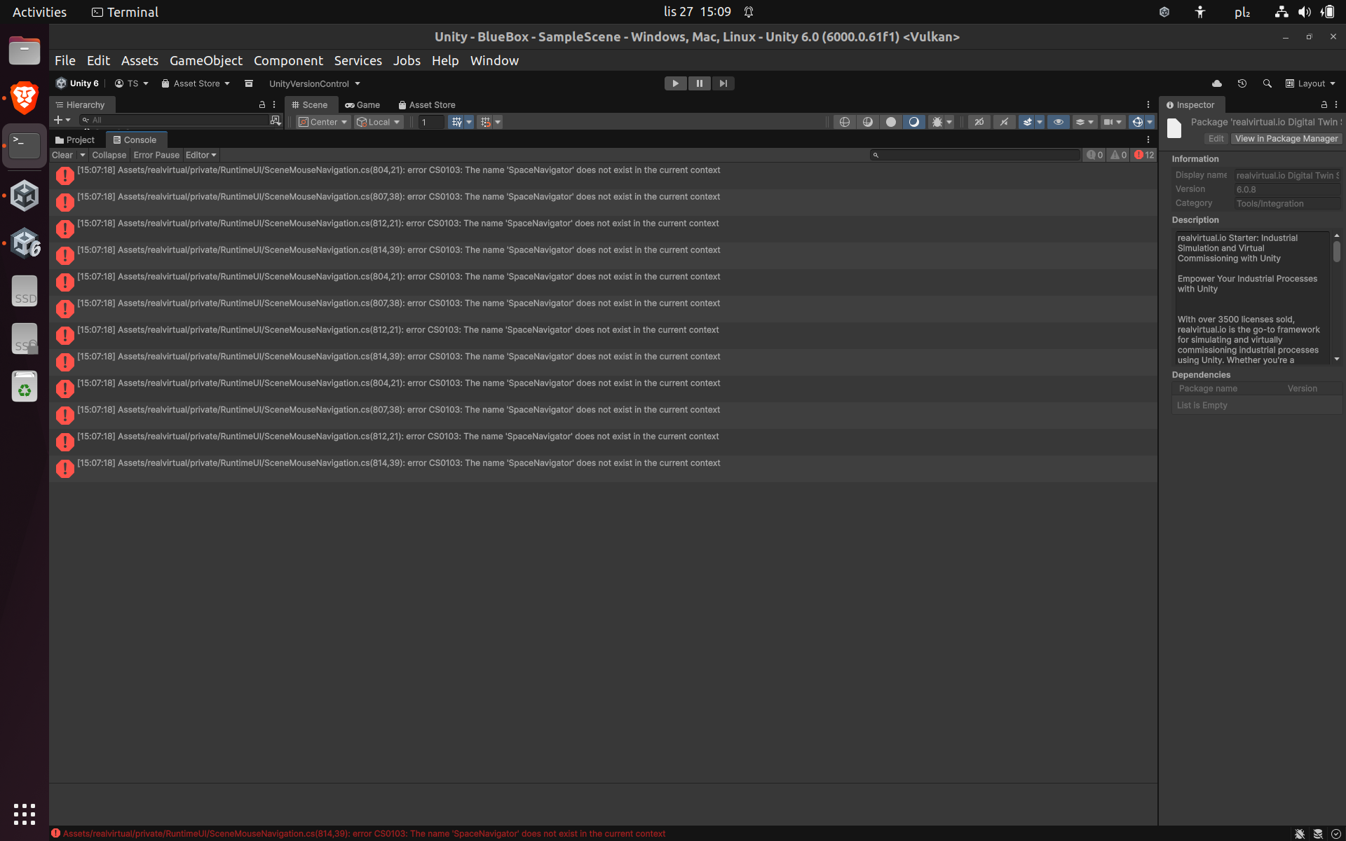

Hi
Ive encountered the simmilar issue while importing realvirtual starter to my Unity 6.0.61 URP, empty project on ubuntu 22.04. After import i get the error from screenshot 15:09.
Ive added compilation scripts like you suggested but then i get other errors from screen shot 15:10 and still realvirtual bookmark/menu doesnt seem to pop up.
Afterwards i tried deleting folder Spacenavigator like its said here:
https://forum.realvirtual.io/knowledge-bases/2/articles/195-errors-concerning-spacenavigator-on-linux-and-mac
after that sometimes the menu pop ups but theres nothing beside login and download update, even after Im logged in.
Im using Vulkan instead of OpenGL if thats some helpfull thread.
Cant wait for yours answer :DD Have a great day
Image 1425
Image 1426

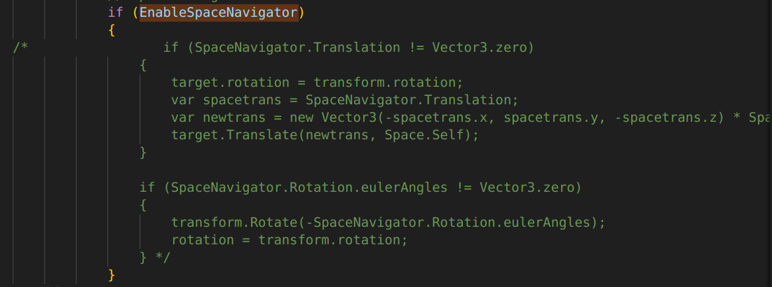

Okey, Its working now!!!
for everybody struggling with same issue, Ive commented out lines 804-816 in Assets/realvirtual/private/RuntimeUI/SceneMouseNavigation.cs and also in line 150, changed EnableSpaceNavigator = true
-> false.
Seem to work fine. Even in unity game mode mouse navigation seem to work like it was meant to work.
