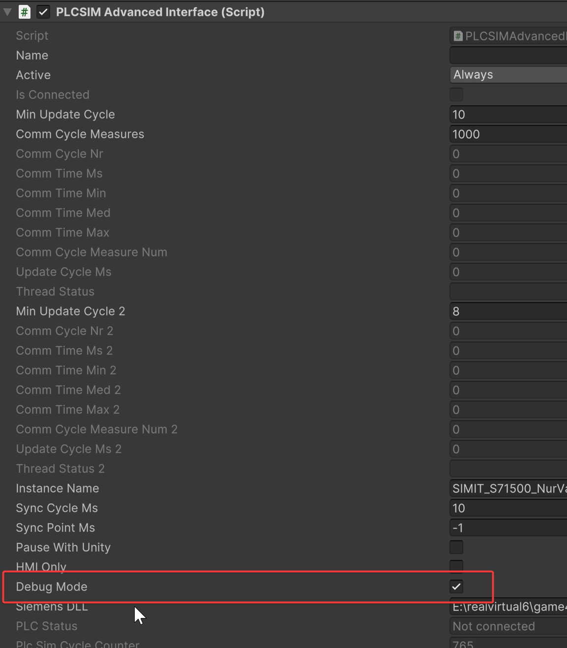

Can you please turn debug mode on and send me the full Unity Console log:
Image 1399
After you did this you should see in the log how to start it manually. Please use a windows console and start it for example like this in my test setup:
E:/realvirtual6/game4automation/PLCSimAdvanced/PLCSimAdvancedCoupler/PLCSimAdvancedCoupler/bin/Debug/PLCSimAdvancedCoupler.exe SIMIT_S71500_NurVar_1 10 -1 debug all
