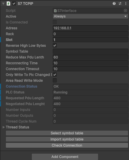

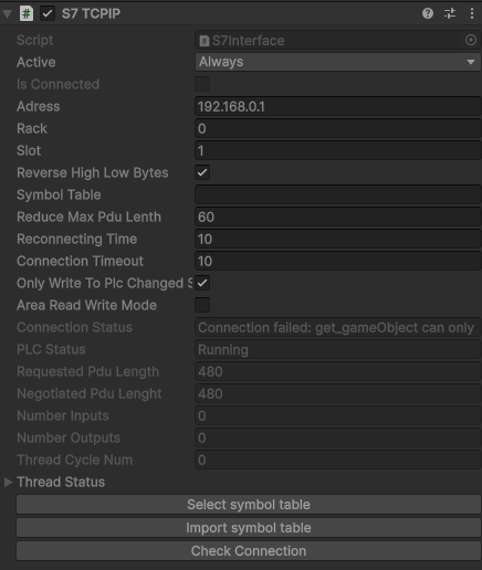

The connection is OK and running in Scene mode, but once in Game mode, I see I have following error:
Connection failed: get_gameObject can only be called from the main thread.
Constructors and field initializers will be executed from the loading thread when loading a scene.
Don't use this function in the constructor or field initializers, instead move initialization code to the Awake or Start function.

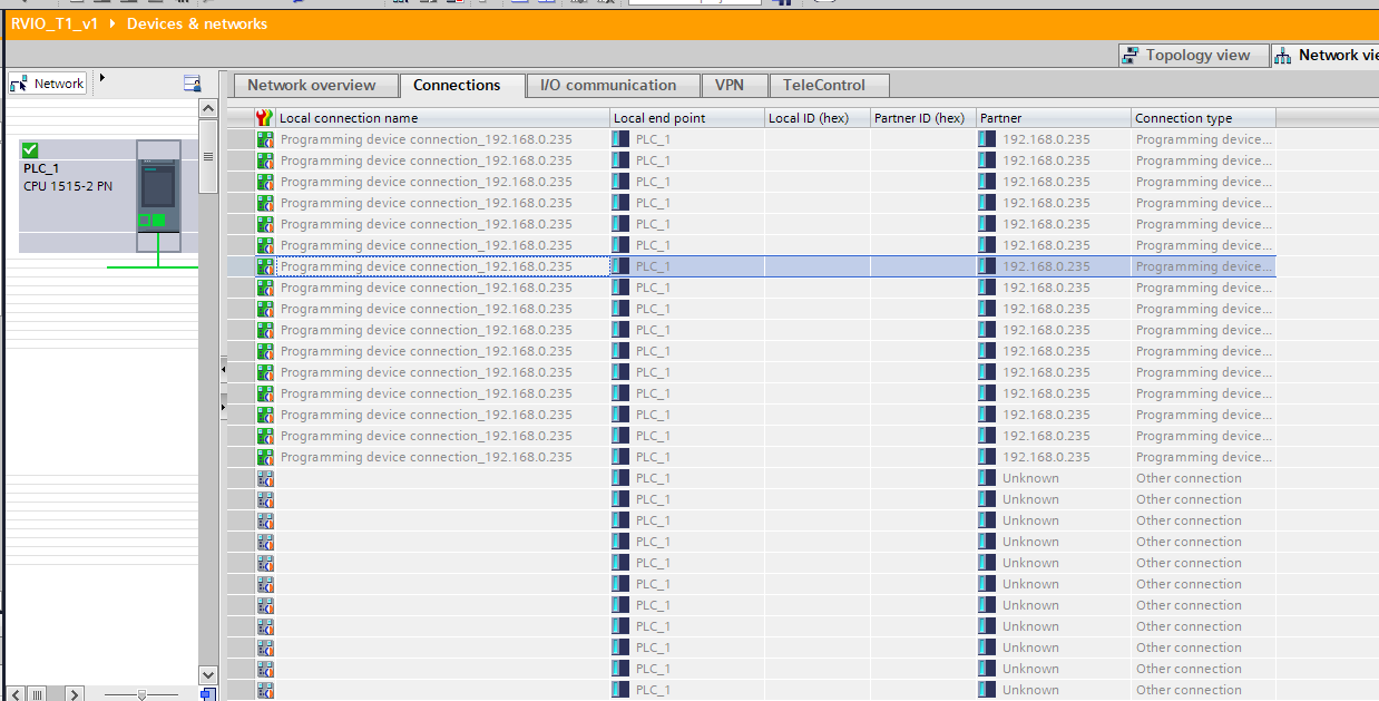

In the connection view of TIA portal I see a lot of connection active.

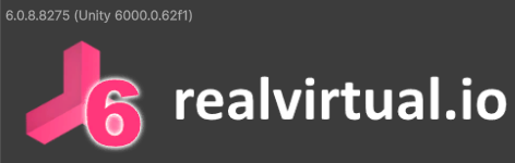

Unity version

Image 1431

Please try changin in line 779 this:
if (connectionstatus == 0)
int ExecTime = Client.ExecTime();
// Use ThreadStatus for thread-safe logging (no Unity object access from background thread)
ThreadStatus = "S7 interface connected - time: " + ExecTime.ToString() + " ms";
Much better!
Never would have find this.
Thank you for your quick answer.
