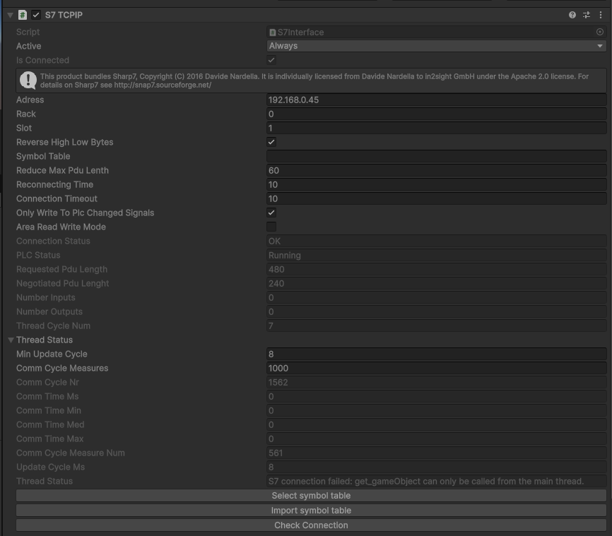

S7 connection failed. I'm getting this error. I'm using the code you sent me.

Hi, when I try to run PLCsimAdvance and configure it, the same error appears as on SS and, the PLCSimAdvancedCoupler.exe download page does not exist.
Image 1458
Thank you, it's working now!
