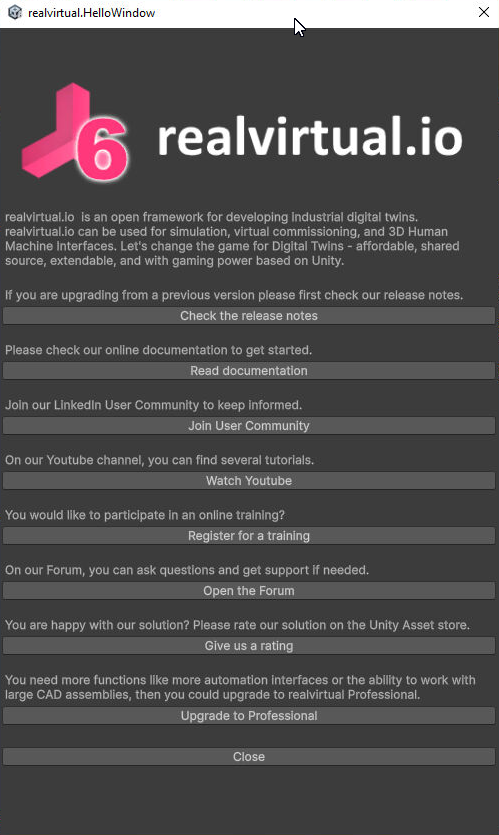

when we trigger our build pipeline and run tests or build the project via script, from time to time the HelloWindow pops up and blocks the pipeline run.
Context
  • We are using realvirtual in a Unity project that we build and test via Azure DevOps.
  • Unity is started from the pipeline in batchmode (no user interaction, headless build).
  • Typical commands are like: -batchmode -projectPath <path> -runTests or -batchmode -projectPath <path> -buildWindows64Player <path> ...
Most of the time this works fine, but occasionally the HelloWindow appears during startup and seems to wait for user interaction. Since this happens on a build server without UI interaction, the process just hangs and the entire CI job times out.

  • Infrequently, the HelloWindow still appears during CI runs, even though Unity is started in batchmode.
  • This blocks the build/test pipeline until it times out.

Image 1447

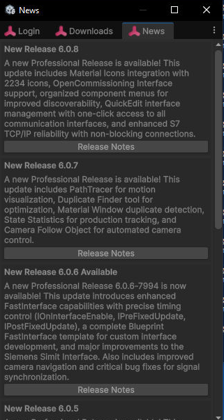

I also see this window (not blocking CI, just annoying).
Image 1448
