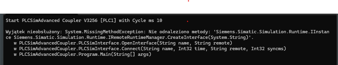

PLCSimAdvancedCoupler MissingMethodException – IRemoteRuntimeManager.CreateInterface not found (all API versions tested)
Philip 2 months ago in realvirtual.io Starter and Professional • updated 2 months ago • 1
I'm getting a MissingMethodException from the PLCSimAdvancedCoupler when clicking "Import Signals" in Unity. No signals are loaded.
Environment:
  • realvirtual.io / game4automation package (older branding, folder in project is still named game4automation)
  • PLCSimAdvancedCoupler version: 6.0.7 (Changeset: 8030)
  • Unity version: 6000.3.2f1 (Unity 6 LTS)
  • S7-PLCSIM Advanced V8 installed
  • All API folders from 3.0 up to 8.0 are present under C:\Program Files (x86)\Common Files\Siemens\PLCSIMADV\API\
  • PLC instance name: PLC_1
Console output from PLCSimAdvancedCoupler.exe:
PLCSimAdvanced Coupler - 6.0.7 (Changeset: 8030)
Instance: PLC_1 | Cycle: 10 ms
Unhandled exception: System.MissingMethodException: Method not found: 'Siemens.Simatic.Simulation.Runtime.IInstance Siemens.Simatic.Simulation.Runtime.IRemoteRuntimeManager.CreateInterface(System.String)'.
   at PLCSimAdvancedCoupler.PLCSimInterface.OpenInterface(String name, String remote)
   at PLCSimAdvancedCoupler.PLCSimInterface.Connect(String name, Int32 time, String remote, Int32 syncms)
   at PLCSimAdvancedCoupler.Program.Main(String[] args)
What I've already checked/tried (all without success):
  • The PLC_1 instance exists and is running in S7-PLCSIM Advanced (verified directly in the Siemens tool, independent of Unity)
  • Manually changed the "Siemens DLL" field in the PLCSIMAdvancedInterface Inspector to point to each installed API version one by one (2.0, 3.0, 4.0, 5.0, 6.0, 7.0, 8.0) — same error every time
  • Unity Editor run as Administrator
  • Antivirus/firewall interference ruled out
  • There is no "Remote" field visible in the PLCSIMAdvancedInterface Inspector to check/clear a remote address
  • DebugMode was available to enable but I haven't seen additional detail beyond the exception above yet
Question:
Since the error occurs specifically in the IRemoteRuntimeManager.CreateInterface(String) call path (not the local/non-remote path), and happens regardless of which installed API version is referenced, is this a known compatibility issue between Coupler 6.0.7 and current PLCSIM Advanced versions (V6–V8)? Is there an updated/patched PLCSimAdvancedCoupler.exe available, similar to what was provided in this related thread: [Link zum Forumsthread "S7PLCSIM Advance connection problem" hier einfügen]?
